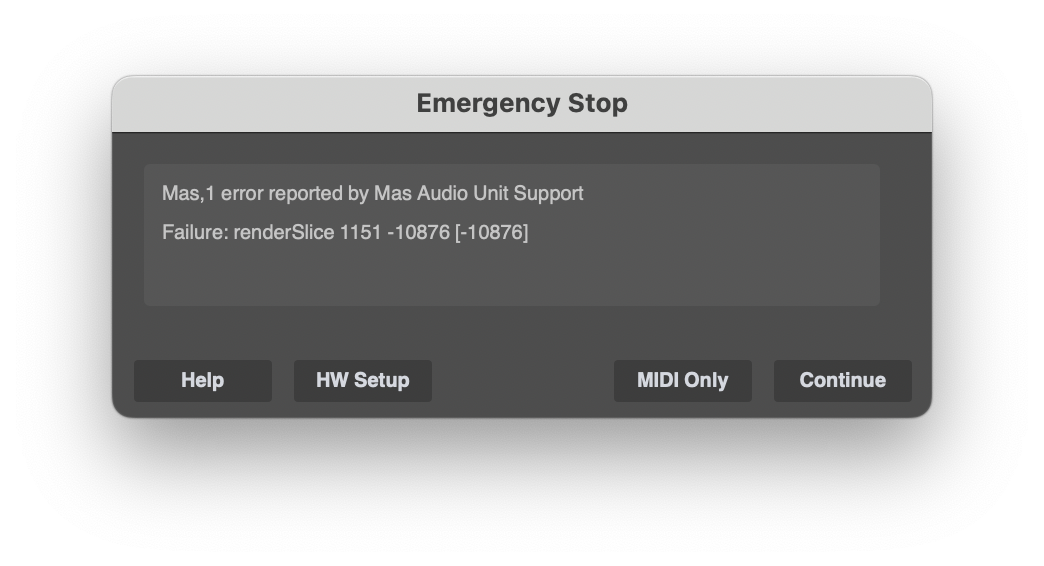

Hello everyone,
I'm trying to load up FM8 1.4.1 on the most recent version of DP 11, but when I do, I receive this error: "renderSlice 1151 -10876" I did some research and it /seems/ it has something to do with macOS Monterey + DP compatibility or that it is being worked on. The post I found goes back four years ago though, so not sure where it's at at the moment.
I tested opening FM8 on a different DAW and it loaded up just fine. Any ideas/solutions for how to get this working? I already reinstalled FM8, reexamined the plugin in the DP preferences, but each time I make a new instrument track, I get the same error. In the forum post mentioned above, someone said removing the Library/Preferences fixed it temporarily, but I can't even find the MOTU preferences on my end.
Thanks so much for your help!

Apple Silicon. Since you haven't told us what Mac you are running, we can only guess that you have an M1 or M2 Mac.
renderSlice 1151 -10876 Error is an OS error, not DP.
The M1 is not 10 years old. In the mean time, FM8 is not AS compatible at all per this support doc from NI.I'm currently on macOS Monterey. I swear that every single time I upgrade the operating system, it either kills support for software I use, or forces me to find a workaround. I just need an offline machine that I never update under any circumstances. That should work for at least 10 years.
https://support.native-instruments.com/ ... ility-News
If you are not on an AS Mac, that this started with an upgrade to Monterey might be the issue. According to this, the last compatible MacOS for FM8 was Catalina:
https://support.native-instruments.com/ ... s-on-macOS
while this bulletin says it works over Big Sur
https://www.native-instruments.com/en/p ... fications/
You should contact NI Support to see if they have any advice for you.

Re: renderSlice 1151 -10876 Error
Ah – makes sense. Yes, I'm on the Apple Silicon M1 chip.
Thank you for posting the Native Instruments links. I had not seen those.
I guess I'm confused as to why this is a M1 chip issue. The standalone version of FM8 opens up just fine, and I can even load up the plugin in a different DAW. It's specifically Digital Performer which doesn't load it up, so shouldn't the issue be a DP issue?

What happens when you run DP over Rosetta 2?ary48682 wrote: ↑Thu Oct 13, 2022 8:10 am Ah – makes sense. Yes, I'm on the Apple Silicon M1 chip.
DP 11.31; 828mkII FW, micro lite, M4, MTP/AV USB Firmware 2.0.1
2023 Mac Studio M2 8TB, 192GB RAM, OS Sonoma 14.5 b4, USB4 8TB external, M-Audio AIR 192|14, Mackie ProFxv3 6/10/12; 2012 MBPs Catalina, Mojave
IK-NI-Izotope-PSP-Garritan-Antares, LogicPro X, Finale 27.4, Dorico 5.2, Notion 6, Overture 5, TwistedWave, DSP-Q 5, SmartScore64 Pro, Toast 20 Pro
Hilarious – guess what? It seems to work just fine! Huh.mikehalloran wrote: ↑Thu Oct 13, 2022 9:08 amWhat happens when you run DP over Rosetta 2?ary48682 wrote: ↑Thu Oct 13, 2022 8:10 am Ah – makes sense. Yes, I'm on the Apple Silicon M1 chip.
Digital Performer seems to be noticeably slower though, but it isn't awful. Thanks so much for the tip! Maybe this workaround is good after all.

Per the NI links to the Customer Care post, FM8 is scheduled to become AS Native at some point (all of Komplete 14 will be). When that happens, running DP over Rosetta 2 will not be necessary unless you are using other non-Native plug-ins.
