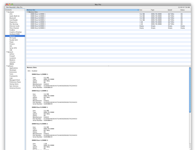

That is a good Idea. i will order some more RAM. I did not get more than 4 because I knew that was all DP could utilize but I forgot about the OS X system needing some also. Duh! Maxing out my RAM sure would not hurt anything
What kind of RAM do I need or do I need to update what I have? I know you have to have RAM stick in particular positions and sizes. Mine are the 667 Mhz. Is this enough or do I need ( or can I ) upgrade RAM speed also? Here is a picture of my system memory profiler.

It won't help things any if you use faster ram than what your ram buss speed is. As far as what ram you need, there's a couple of ways to find that out. One is to download MacTracker - that will tell you most everything you need to know about any Mac that's ever hit the market. A second way is to go to Crucial Memory at http://www.crucial.com/" onclick="window.open(this.href);return false; and run through their memory finder routine on their site. That will tell you what's possible. A third way to go for ram is to go to OWC at : http://www.macsales.com/" onclick="window.open(this.href);return false;. Pretty decent ram prices and within a couple of bucks or so of Crucial. The thing with Crucial is they may not tell you all the memory options possible with your computer. But I have purchased from them in the past and never had a problem - just ordered 8 gig (2 4 gig ram sticks) for my new Mac Mini for $116 plus shipping and tax from them. Should get it just after New Years.donreynolds wrote:That is a good Idea. i will order some more RAM. I did not get more than 4 because I knew that was all DP could utilize but I forgot about the OS X system needing some also. Duh! Maxing out my RAM sure would not hurt anything

Also consider how much of DP's RAM is shared with VIs and plugins. With enough RAM beyond your current 4GB, you could offload some of your VIs to run them in standalone mode which will give each standalone its own memory space without sharing RAM with DP. I started with 8GB and am now up to 16GB.donreynolds wrote:I did not get more than 4 because I knew that was all DP could utilize but I forgot about the OS X system needing some also.
You can find your RAM type under About This Mac > More Info. If our machines are the same, your RAM specs should be "DDR2, 667Mhz, PC2-5300, 1.8v, 240 pin, ECC Fully Buffered". Whatever brand you get, make sure it specifically says "Apple Approved" or "Apple Certified". The sticks should have the proper heat bonnets (heat sinks) on them. You could also call the merchant to confirm your computer model and RAM requirements.
