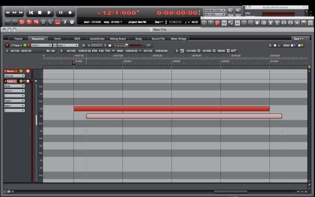

1) Grid - if the grid is on, the click will place the note on the nearest gridline to the left of the pencil tool. That is "absolute grid." Not relative. Absolute. Set the spacing of the gridlines by typing in the note value in the time-format you are using. Thus, 0|240 is an 8th note. 0|120 is a 16th. 1|000 is a quarter note. And so on.
2) Click-Drag - Click places the note. Drag determines the length. With grid on, both the click and the drag are constrained to the nearest gridlines. The click goes to the nearest gridline to the left. The drag goes to the nearest gridline to the left OR right, whichever is closer.
3) Command Key - toggles the grid off for the click, And/Or toggles the grid off for the drag.
4) 2nd Click on the Same Note - erases the note you just clicked into existence. The pencil has an eraser!
5) Next Insert - your first click-drag determines the length of all subsequent notes until you click-drag again. You can make the notes any length. Click-click-click… very fast.

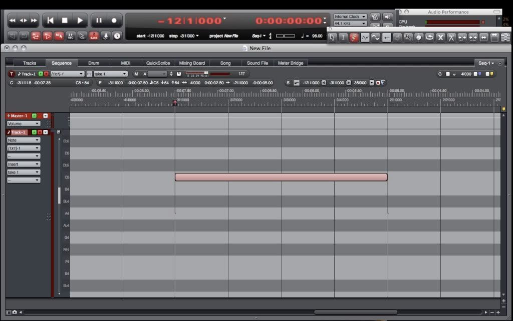

The behavior of the pencil tool at normal zoom levels (Shift-Command-N for the default zoom level), is quite nice, actually. With the grid on, it will peg any click of the pencil directly onto the beat or subdivision of the beat. That's an absolute grid. Once you click, you hold it down and drag until you've got the length you want. If you want odd lengths, you press the command key while holding down the mouse button, then drag to the desired length.
After the first click and drag, DP's Pencil tool will attempt to make each following note-click the very same length as the first click-drag. In other words, once you tell DP how long you want the notes, it will make them all that length until you tell it to change.
When you want a new note-length, you just click-drag again as described above. Now you've told it a new length, and it will make subsequent clicks the same length unless you add the drag to your click.
High Zoom Levels:
At high zoom levels, it's doing the very same thing, but the "envelope" of your click-drag happens to be wider than the window. So, it will either appear to be placing a giant note whose end points you can't see, or you will try to click-drag, and possibly fail, since the next gridline falls offscreen. If you can't make your drag reach the next gridline, it will either place a very short note where you clicked (on the grid), or it will extend the note to where you drag if you hold down the Command Key.
It may seem illogical at first at high zoom levels, but I promise you that if you play around with it at normal zoom levels, you'll soon see the er… logic… of the pencil tool's behavior at high zoom levels.
