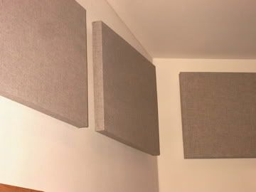

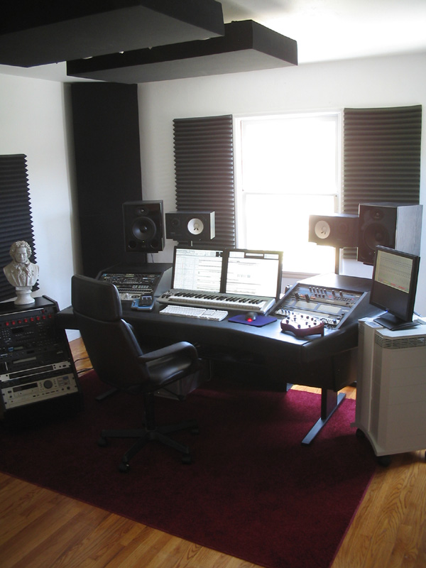

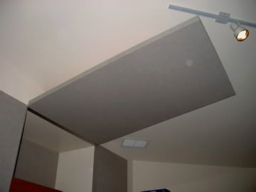

Well, all I can say is I bought the 2x4x4" GIK panels and they were made well and look nice and seem to do the job nicely. They could do with a few more standard colors though, that's for sure. I bought the black ones pictured below in the corners (2 standing on top of each other) and the clouds:
- Posts: 10394
James, I had forgotten how gorgeous your studio is. Nice!

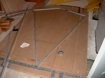

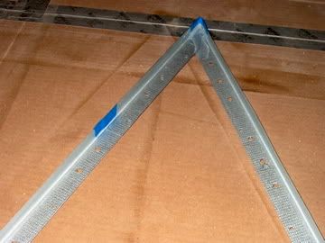

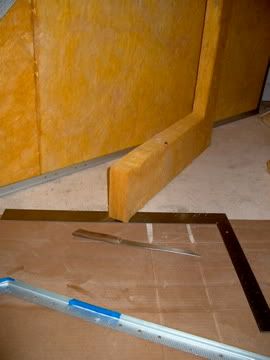

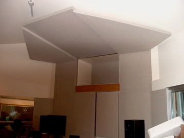

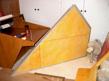

If budget is an issue, DIY panels/cloud made from rigid fiberglass (like 703)can work wonders. Use quality fabric to make things look nice and space panels well away from the wall/ceiling to maximize lower frequncy absorbtion. Here are some pics of the panels/cloud I built from rigid glass, drywall corner bead, masking tape and silicone and 3m Spray Adhesive. Guilford fabric makes for a nice finish.
Depending on the rigidity of your wallboard, bass trapping may or may not be necessary. If your walls are flexible, they may do a pretty good job taking care of the low end. However, trapping is usually required, more so if your walls are rigid, as they typically are in studios.

Thanks! The metal corner bead makes for a clean creation without subjecting onesolf to the fumes inherent to resin-based edge hardeners. 3M spray adhesive isn't too bad... Was well worth the effort. I'll be doing it again when my new room gets finished.Tonio wrote:Hey nice work HC !!

Nifty! Of course money is an issue - otherwise I'd build a whole new room. I've found and ordered a 'box' (12 2x4 panels) of 2" 703 so I think I'll be following your example here.HCMarkus wrote:If budget is an issue, DIY panels/cloud made from rigid fiberglass (like 703)can work wonders. Use quality fabric to make things look nice and space panels well away from the wall/ceiling to maximize lower frequncy absorbtion. Here are some pics of the panels/cloud I built from rigid glass, drywall corner bead, masking tape and silicone and 3m Spray Adhesive. Guilford fabric makes for a nice finish.
